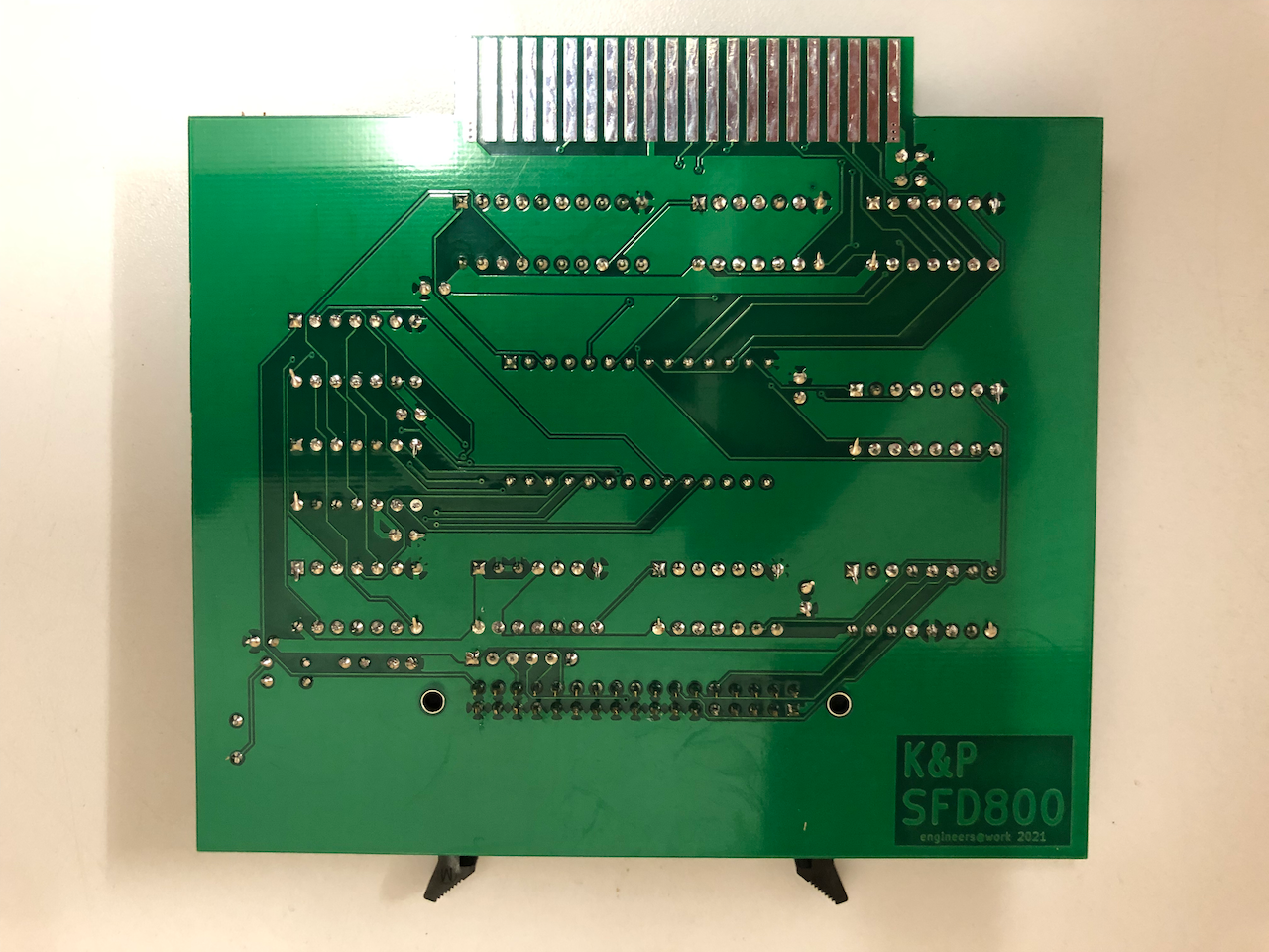

Re SFD800 PCB - I received the PCB's but found a serious mistake generated by Kicad. The SFD800 uses hand drawn (or similar) tracks and the power supply tracks are very wide, probably overkill. Rather than creating several large track types in the Kicad definition, I laid out the power supply using parallel 0.802mm wide tracks with a gap in between with the intention to copper fill so that the a large single track is created. After complete PCB layout and DRC checks I first made GND copper fills and made a DRC check then +5V copper fills (to fill in the gap between the 0.802mm parallel tracks). After a final DRC some issues were flagged relating to distance between tracks too close but mainly on the board edge so it wasnt an issue. Well, PCB's ordered and arrived, I thought I'd make some checks and noticed that GND and +5V were shorted. After closer inspection GND and+5V copper fills had actually merged. If you shorted GND and +5V together on Kicad PCB the DRC would flag a short but making two copper fills, it not only shorts them together but the DRC doesnt flag the error! I retried the board making the copper fills and found that the moment you made two copper fills using different nets, it shorted them!!!! I've had a few issues with Kicad and always put it down to my fault or computer crash but this is actually a reproducible error!
Short explanation long, I redid the PCB using only GND copper fills and manually filled in the +5V gap between the parallel 0.802mm tracks, made extra extra checks and the PCB is with the manufacturer being posted today! I'm still waiting on some parts so hopefully next week I'll get the chance to assemble and test a board and if all ok let you/arnuphis know.
Kicad is great software but a few issues like the above can really emphasise I need to check and triple check!

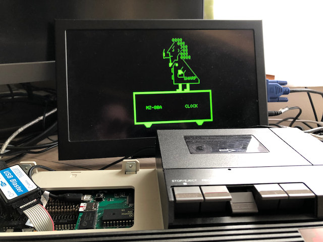

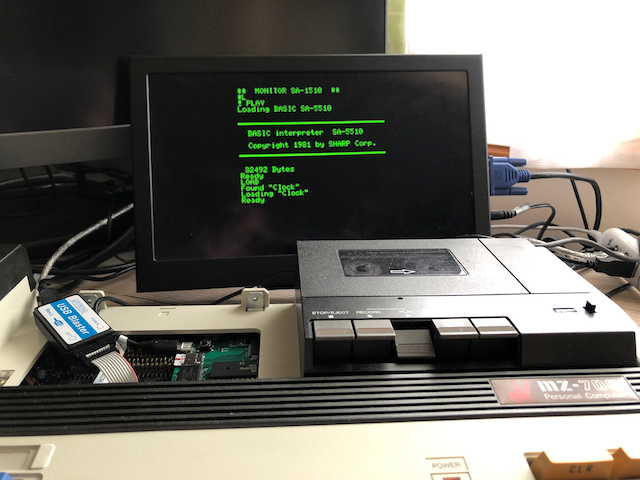

If anyone is interested, a Sharp MZ-80A running on a Sharp MZ-700 Host using the MZ-700 tape deck. This is a fusion of the Sharp MZ Series Emulator and real host hardware. I'm currently porting and modularising the emulator so that it runs standalone on the MiSTer project but also inside a Sharp host utilising original hardware where available.

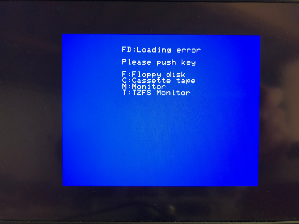

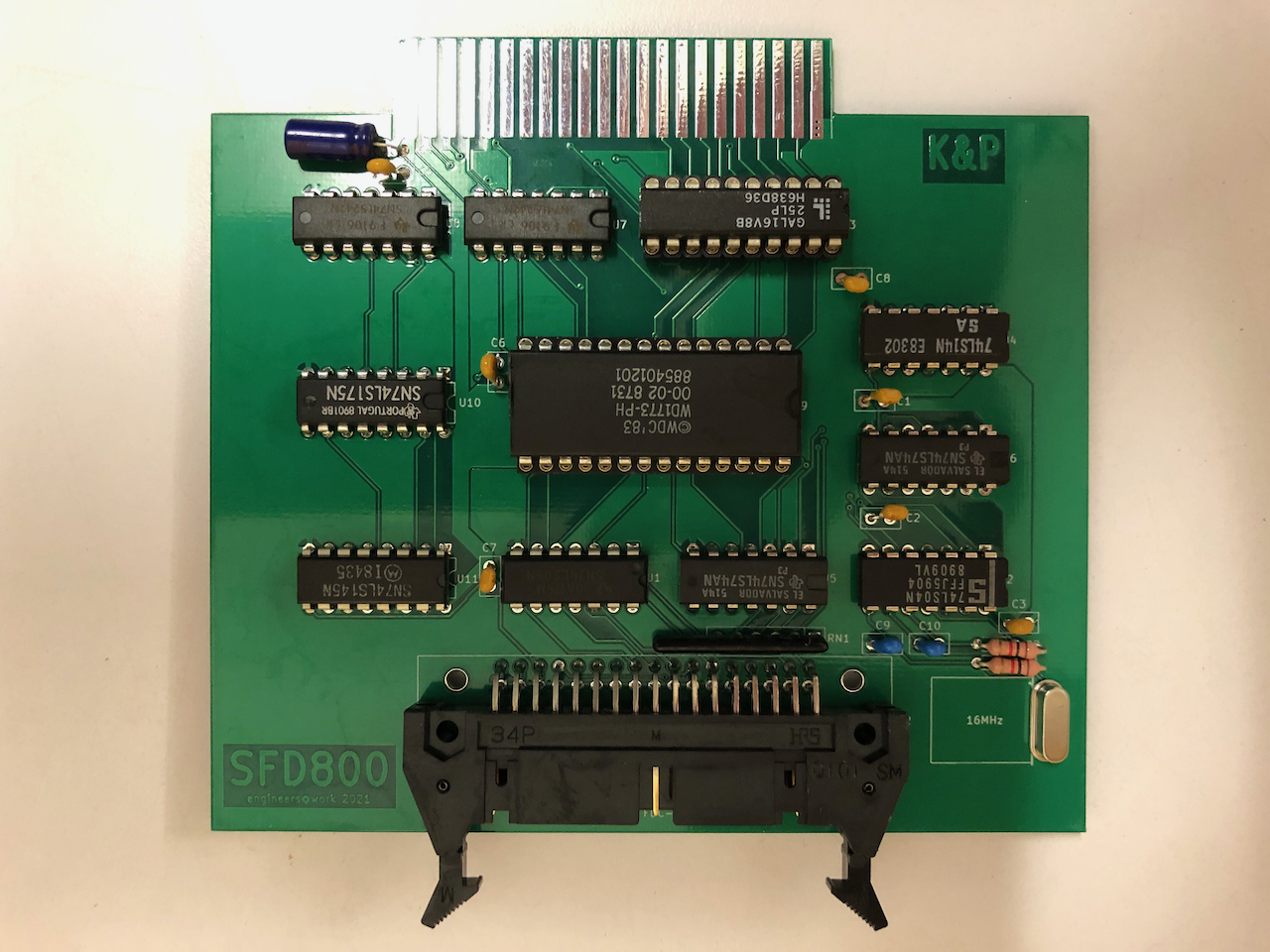

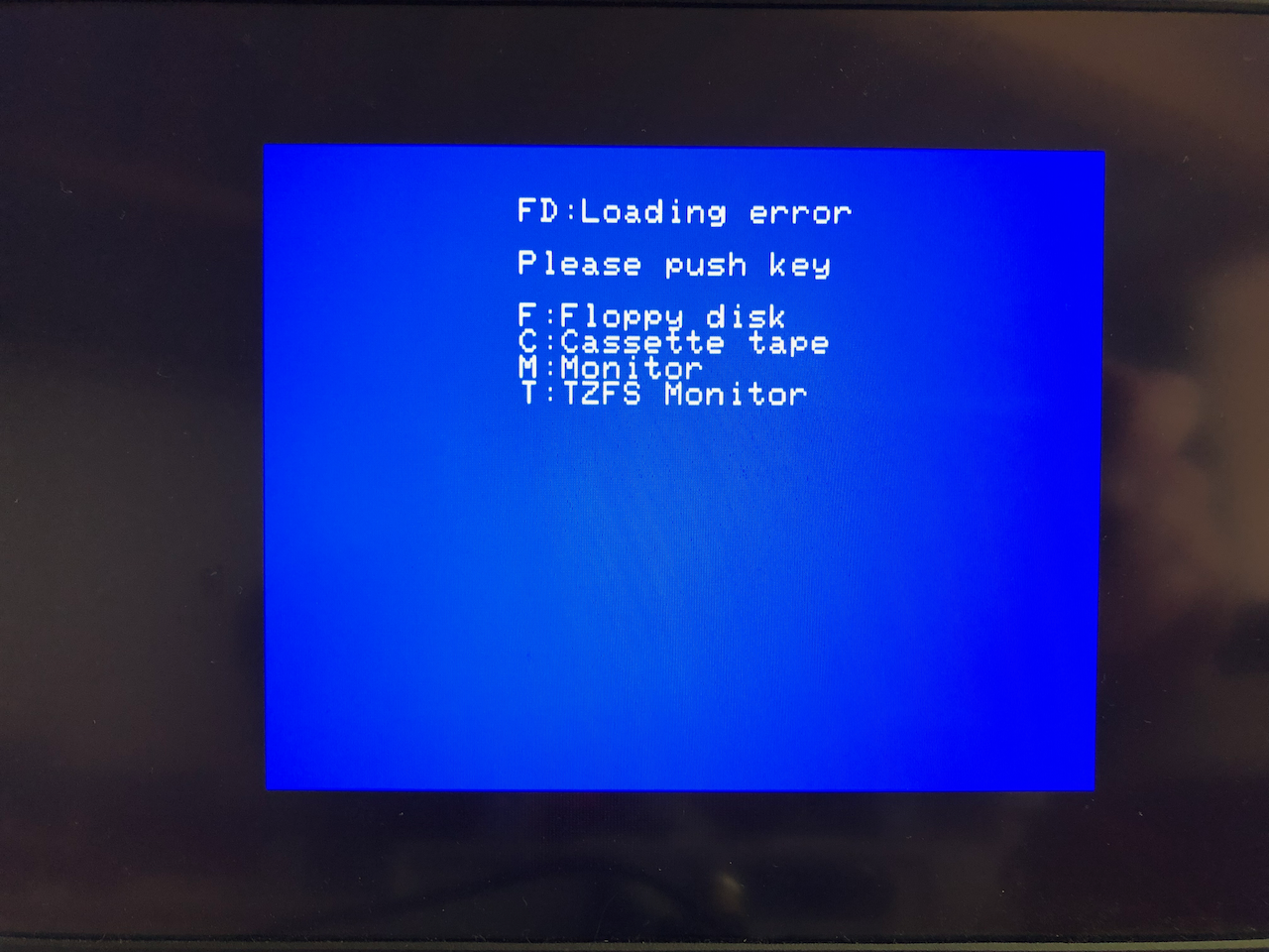

Just an update on the new board.
PCB's received and first sample built (below). Powered up and it seeks the drive but always ends up with a loading error (screen below). I set about analysing the original board and the new board and found the XTAL circuit on the new board was outputting 8MHz when it should be 16MHz. Seem Ebay was a bad choice for the crystal, clearly marked 16MHz but not outputting 16MHz!!!!!!
Will change the crystal next Im in my workshop and rerun the test, but looking good.

Re: MZ-80b FI/O to HxC Cable
Looking good. Shame about that crystal but at least its an easy fix
All working, it wasn't the crystal per-se, slightly different crystal spec (it was bought from RS not Ebay!!!!) and needed the bias adjusting (R1/R2) and now ticks happily at 16MHz.
