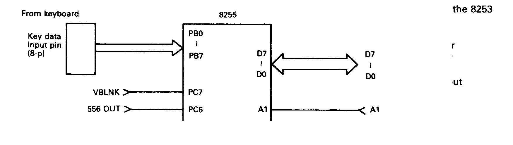

It doesn't work on a real 800 either. Strange that keyboard is working but VBL not, when both is handled by the 8255. Oh well, I'll worry about this later :)

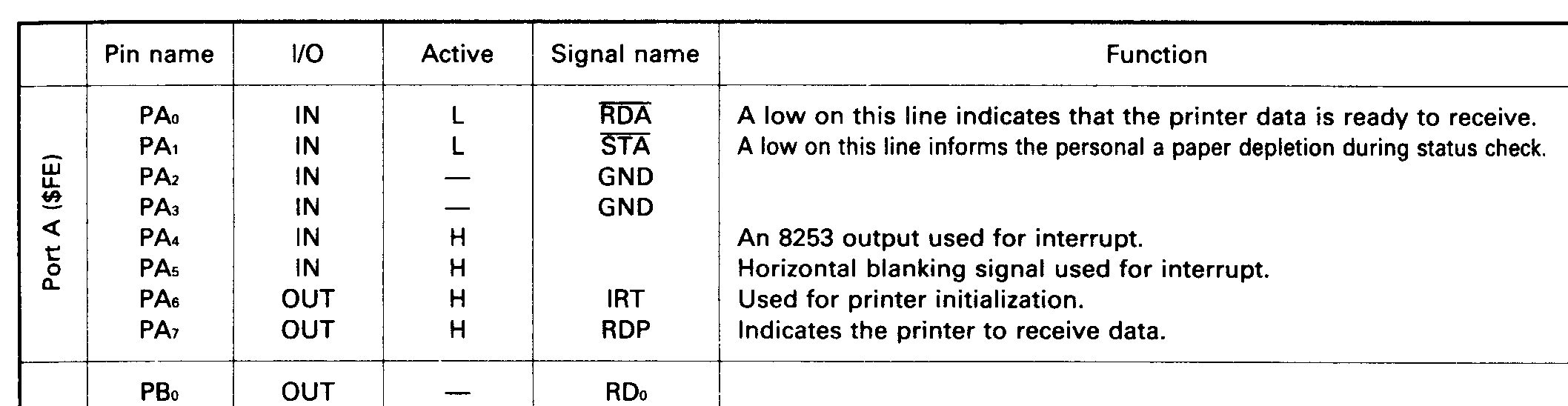

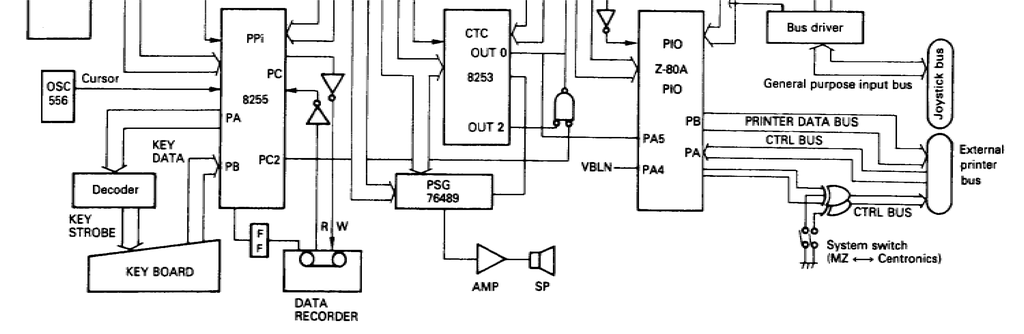

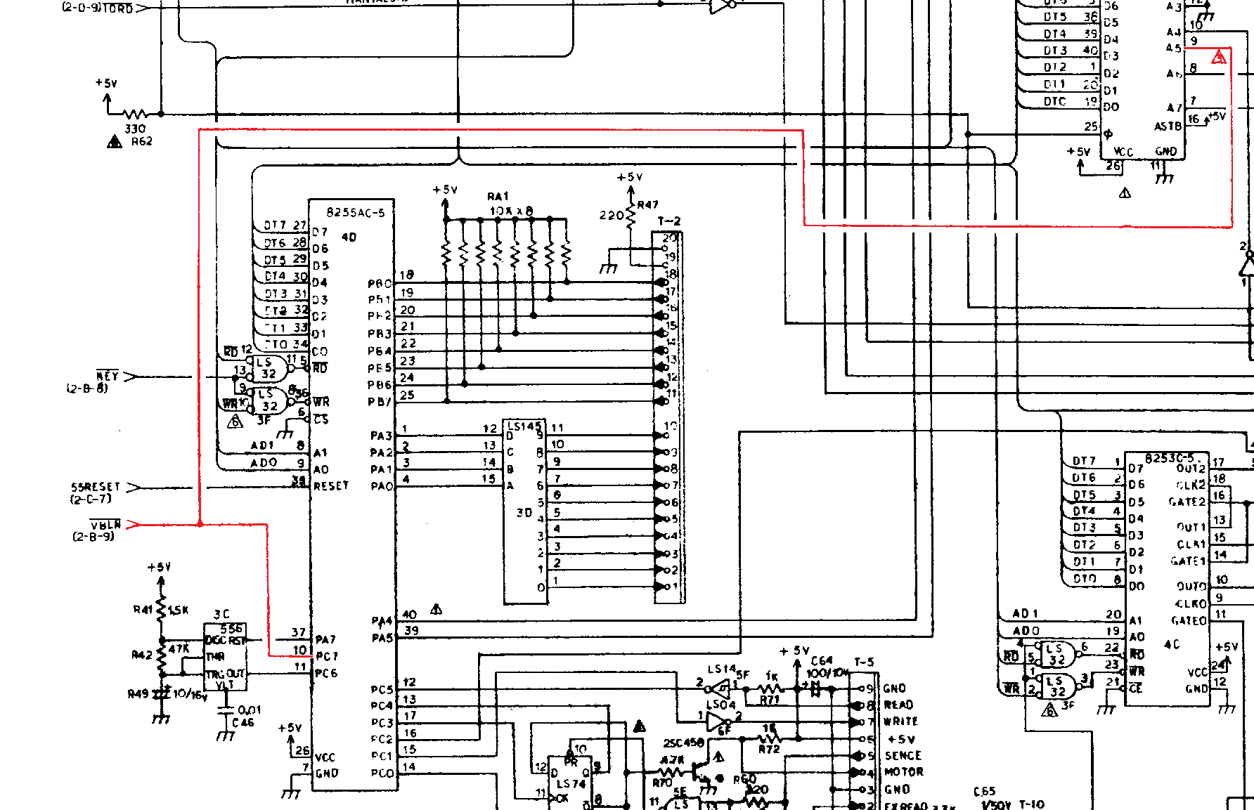

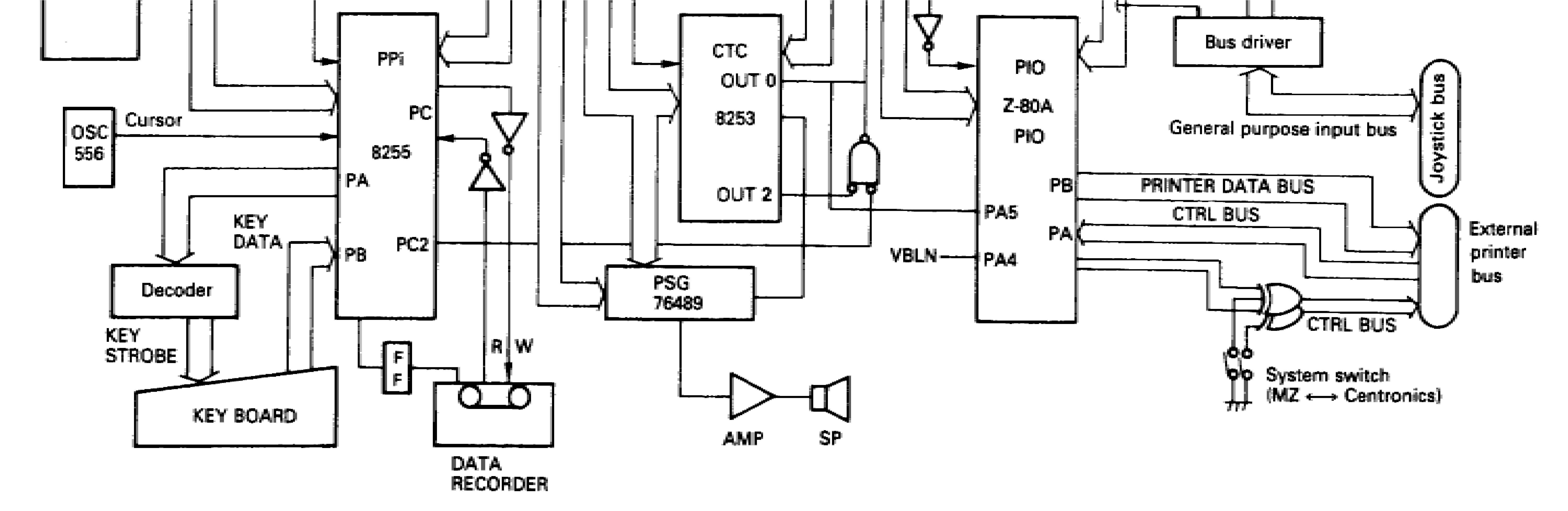

Remember I told you /VBLN is connected to two pins: 8255 and PIO. I'm not sure why PIO needs it and in which direction it is (is that an input or output?).
Re: Detecting VBL on 800 in 700-mode

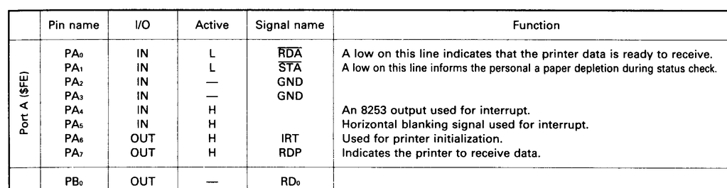

- PIO.A5, is input, reading 1 when its source is not active.
- 8255.PC7, is input, reading 1 when its source its source is not active.
Could you post you snippet of source which doesn't work with MZ800 (I suppose you're in MZ700 mode)?

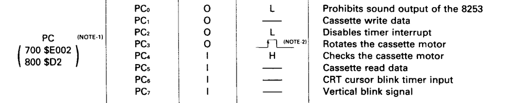

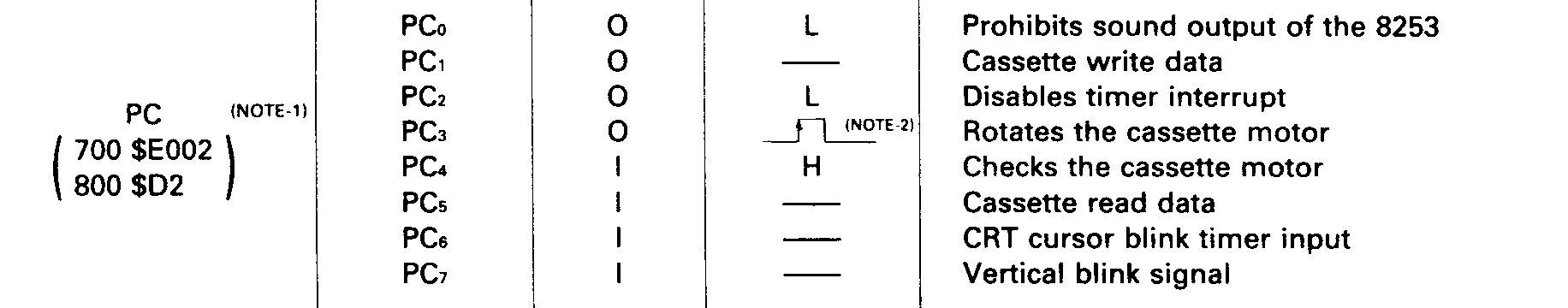

while (*(unsigned char *)0xe002 & 0x80);
This is working on the 700 but always returns immediately on the 800 emulator in 700 mode.

Ok, it seems PIO of MZ-800 can issue an interrupt for /VBLN, I suppose when you execute the PIO interrupt, you must check PA5 to see if /VBLN is the interrupter. While in MZ700, I guess there is no such interrupt so you should rely on polling PC7 of 8255. But for an unknown reason it doesn't work...
Yes, there is no VBL interrupt on the 700. I expected the 800 to work in the same way in 700 mode, but apparently not. Tested on both emulator and a real 800. Keyboard is working in both cases, which it wouldn't unless running in 700 mode with correct memory map.
