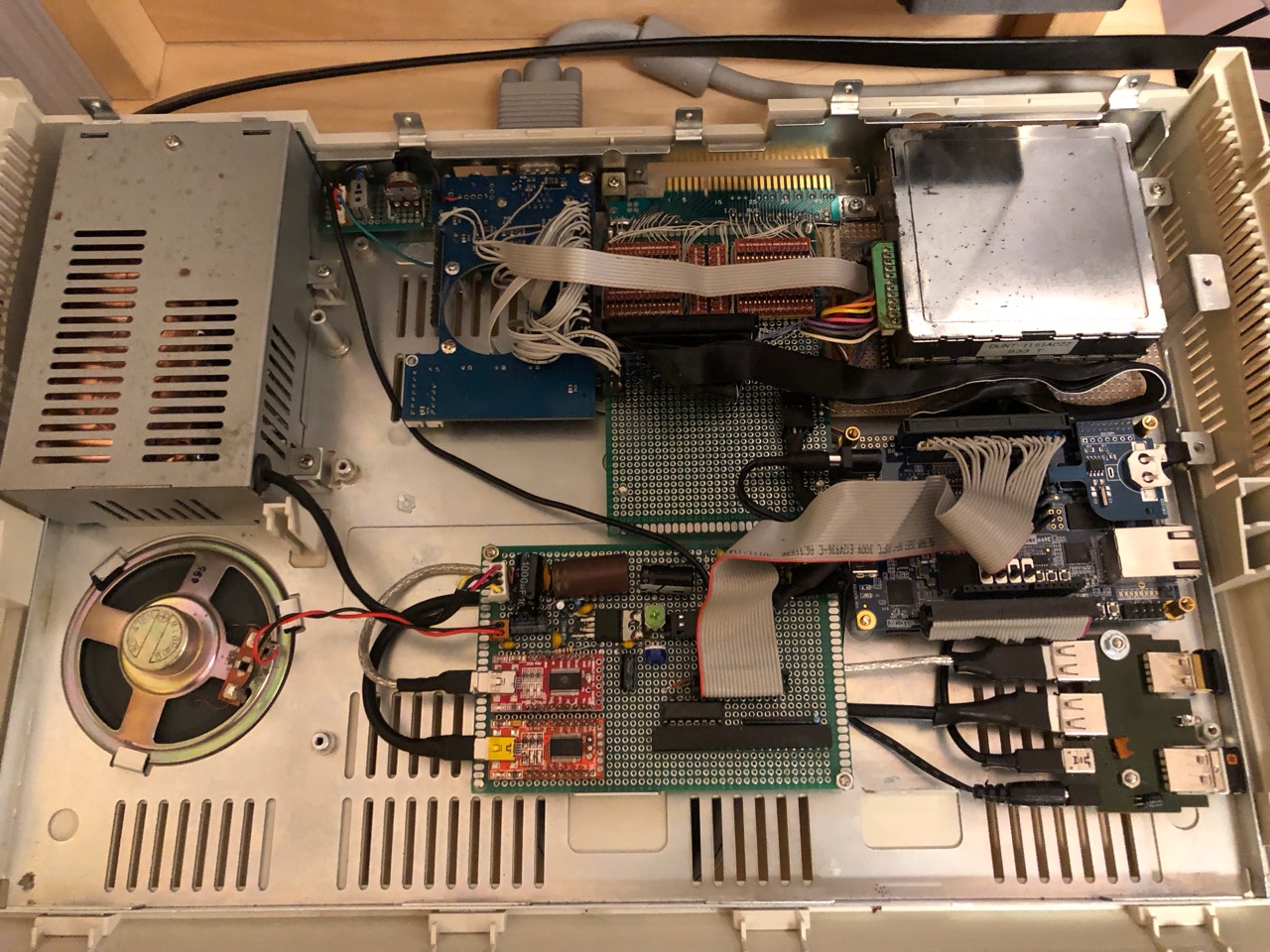

Below is a project I started last year with MiSTer but havent quite finished it, It works but needs the keyboard decoder adapting for the real keyboard and the interface bus drivers coding. I blew the motherboard of the MZ700 (PSU failed and without thinking, I noted the colours of the PSU power lines and connected 12V as they were yellow+black...big mistake!). Hence converting it into a MiSter machine.
Re: Sharp MZ Hardware Emulator on MiSTer
What a shame... huh... shade! That's weird, MZ-700 PSU is not supposed to offer 12V so you pick it from a modern PSU? I guess so. Anyway, keep good job and don't refrain yourself from giving us progress report (could it be a link to your blog for more details).
