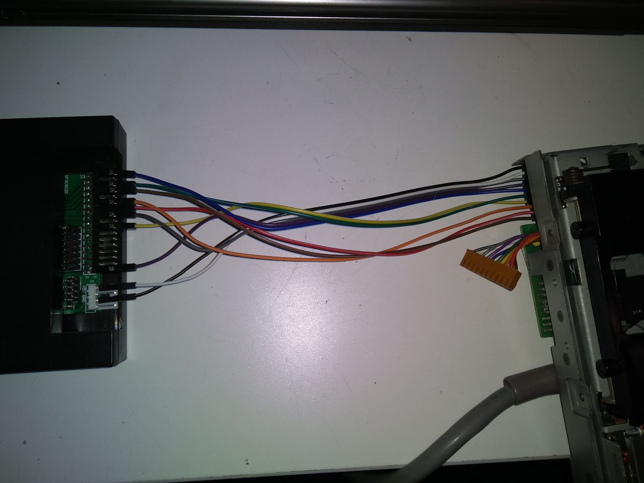

I actually wired up a GOTEK to my controller (the bottom half of the MZ 1F11) And it tries to work but it's not quite there yet.Hint: the gotek can emulate an QD-Drive too !!
Has anybody else tried to do this with any success? I can format and ask for a list but writing seems to fail.
Re: Gotek drive emulator
Did you follow the guidelines for how to connect Gotek pins to a QD-drive interface? that's quite different from the Gotek pins to connect a FD-drive interface. https://torlus.com/floppy/forum/viewtop ... 010#p21010
Jup that's what I did, though my info came from https://github.com/keirf/FlashFloppy/wiki/Quick-Disk . I Even used the same colorcoded wires from my breadboard to set it up.
Oh Keirf... I wouldn't judge here... Keirf isn't Jeff and Keirf has the habit to copy Jeff's new features and sources. You probably need to stick with Jeff's solution as it was validated with his firmware.
Good to know, I will try that firmware next. Will report back.
Ok, I never tried Jeff's firmware in the end but decided to help to get the flashfloppy firmware fixed. The experimental firmware I got seems to work!
